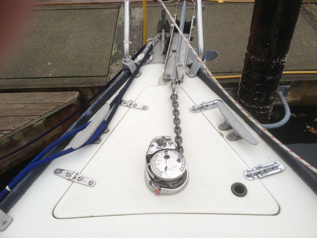

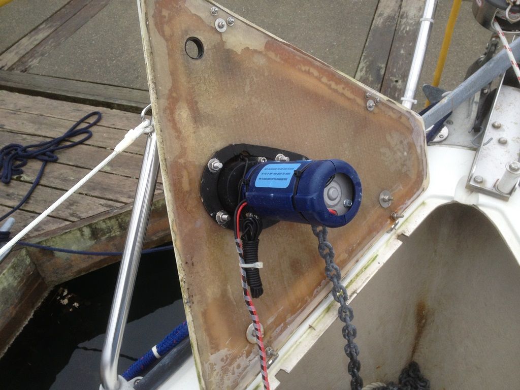

  Re: windlass (Van_Isle)
Posted: 11:50:57 am on 1/22/2015 Modified: Never
This is what the previous owner did on my MkIII. Honestly I haven't had much opportunity to use the setup yet.
North Saanich, B.C.
