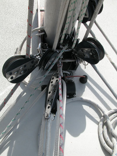

> I suppose I'll need to drill into the deck and add some.
Don't do that.
Ralph, I think, mentioned that blocks are normally secured to the alloy channel in which the mast base rests. You can see a photo here. This is a bit of a rat's nest, but I think you can see that the blocks are secured to lengths of rod that bridge the channel. There are additional holes at the forward end. Some people add a piece of alloy to the side of the channel and mount the blocks on standup springs, etc.
If you now go to Black Arts >> Genoa Tracks, some of the photos just show people's arrangements of line stoppers at the aft end of the coachroof and way off in the distance, the deck organizers that lead the lines aft.

David is right. I just didn't explain myself good enough. The blocks at the base of the mast are attached  to the mast step. Not through the cabin top.
I also have organizers leading these lines aft to the clutches.
